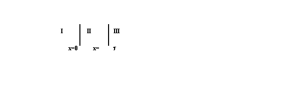

Consider the three-region slab configuration shown below.
The absorber region (Region II) extends from x=0 to x=t and is assumed to be a source-free region which scatters neutrons isotropically. Since the angular fluxes y(x,m) incident on Region II from Regions I and III must be continuous at the boundaries,
yII(0,m)
= yI(0,m),

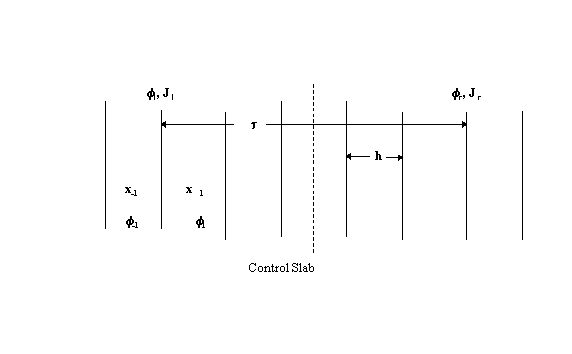

A.4 Evaluation of the Effective Diffusion Parameters
The effective diffusion parameters are chosen so as to preserve the current-to-flux
ratios on the surfaces of the control slab as given by the blackness coefficients.
Since these effective diffusion parameters are to be used in a finite difference
solution of the diffusion equation, they contain an explicit dependence
on the mesh interval size, h. This allows the use of a very coarse mesh
in the absorber for diffusion calculations. Equations will be derived for
the effective values of D and Sa for
use in those diffusion codes, such as DIF3D4, which evaluate
fluxes at the center of mesh intervals. The same methods may be used to
determine the effective diffusion parameters for codes which evaluate fluxes
on mesh interval boundaries. These techniques for determining mesh-dependent

Consider the following diagram.
It is convenient to assume that the same material extends to regions
outside the absorber slab of thickness t. Since
a and b depend only
on the properties inside the slab, this assumption leads to no loss in generality.
If the flux varies linearly from the center to the edge of the mesh cell,
fl = (f-1
+ f1)/2 and Jl = (D/h)(f-1
- f1) .
The solution to the diffusion equation within the source-free absorber
consists of a symmetric (cosh kx) part and an asymmetric (sinh kx) part
with respect to the centerline. For the symmetric solution, fl
= fr , Jl = Jr
, f1 = C cosh k(t
- h)/2, and f-1 = C cosh k(t
+ h)/2 so that after some manipulation
Similarly, for the asymmetric solution, Jl = -Jr,
fl = -fr,
f1 = A sinh k(t
- h)/2, f-1 = A sinh k(t
+ h)/2 so that
The ratio of these equations gives
from which it follows that
The expression for the effective diffusion coefficient is obtained by
adding the equations for a and b.
An expression for the effective macroscopic absorption cross section
is obtained by writing the diffusion equation for the control slab in finite
difference form and solving for Sa.
Thus,
where
fn = C cosh kxn
fn+1 = C cosh k(xn + h)
fn-1 = C cosh k(xn -
h) .
These equations for k, D, and Sa
determine the effective diffusion parameters in terms of the blackness coefficients
(a and b) and the
mesh interval size h for the case of mesh-centered fluxes.
