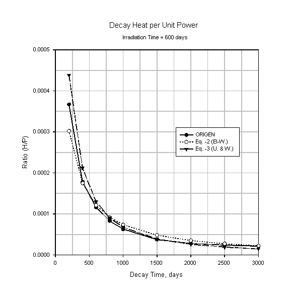

A plot of the ratio ()
for Eqs. -2 and -3 are shown in Fig. 2 as a function of decay time and for an
irradiation time of 600 days. The ratio calculated with the ORIGEN code is also
shown for comparison.
Example Attachment
Graph
Figure 2. Comparison of Decay Heat Equations-2 and -3 with
ORIGEN
These data clearly show the relative decay heat estimated by the decay heat expressions for a typical irradiation time. The ORIGEN ratio is in good agreement with both Eqs. -2 and -3.

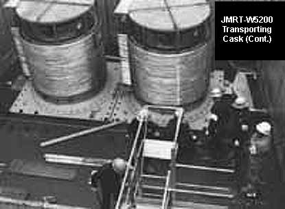

Example Attachment
Photograph
